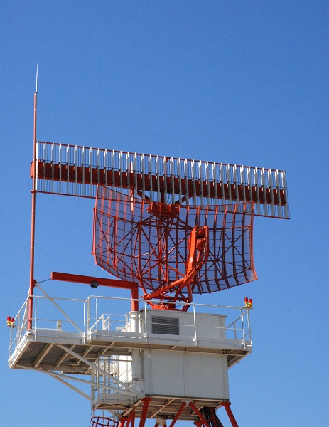

Thales STAR-2000 PSR (spoiled-parabolic antenna below) with co-mounted RSM-970-S SSR (rectangular dipole array antenna above):
STAR-2000 range depends on transmitter power configuration and can be 60, 80, or 100 nm (note that this range is applicable to non-cooperative targets, ie. no transponder/beacon in the aircraft, hence can be used to detect unknown/opfor targets):
https://www.thalesgroup.com/sites/default/files/asset/document/star2000_datasheet.pdf
one of these PSR+SSR combo sets can be found in Manila Airport (NAIA), and one can be found in Mactan-Cebu Airport (more on these airport radar sites in a followup post)...

Manila Airport (NAIA) Radar
historical summary of manila radar center as published in CAAP website (emphasis mine):
http://ats.caap.gov.ph/index2/manilaapp_about.php
MANILA APPROACH CONTROL
1960. Manila Control Tower provides both approach and aerodrome control services, there was no Radar equipment at that time thus, conventional approach was used to provide separation for arrival and departure and to monitor other traffic.
1968. The USAF in Clark Air Force Base (Pampanga) lent C.A.A. MPN 13 mobile radar and trained selected ATCs in the use of radar for approach control service. The MPN 13 radar is an analog radar that gives only primary responses represented by small moving blips. These blips are the actual position of aircraft in flight.
1975. New facility building was built to house the new Italian made SELENIA radar and approach control service was separated from the old MIA control tower. ATCs were trained in the use of the new airport surveillance radar. The SELENIA ASR provides the controller a better way of identifying aircraft with the use of secondary blip (SSR) response aside from the primary.
1979. After using the SELENIA radar for four (4) years, the Japanese government gave us the TOSHIBA radar system (analog). Toshiba radar has similar features with that of Selenia radar. Both radar are selected on Mode A only, and no Mode C capability yet.
1982. An update TOSHIBA radar system was acquired, which introduces use of digital Alpha/Numeric system and mode C. The Alpha/Numeric TOSHIBA radar was digital and with capability to determine aircraft on mode C, the altitude response of an aircraft in-flight. The aircraft represented by blips. The data that the controller can read on the radar display are the following:
Aircraft call sign A/C ID
Aircraft speed reference to ground speed (knots)
Aircrafts altitude (feet)
2001. In view of the fast deterioration of the performance of Toshiba Radar system due to lack of spare parts and obsolescence, a new NEC Radar system was acquired from the Japanese Government as grant. Building construction and facility renovations started to house the NC Radar system. The new system has the following features among others:
Airport Surveillance Radar (ASR)
Mono-pulse Secondary Surveillance Radar (MSSR) and
Terminal Radar Data Processing Sub-System (TRDPS), modern type of alpha/numeric radar.
2003. October of this year the new NEC radar system was officially commissioned for operation.
The operations and training facilities of Manila Radar is located at Radar St., Merville Access Road, Pasay City.
this radar center is located near the NAIA runway:
this site can be seen in google maps here:
https://www.google.com/maps/@14.507935,121.024154,400m/data=!3m1!1e3
from the above info we can infer that the Toshiba and NEC radars were likely installed in the radomes pictured above...
as posted in an earlier post (http://defenseph.net/drp/index.php?topic=712.msg2859#msg2859), back in 2010 five sets of STAR-2000 primary radars with co-mounted RSM-970-S secondary radars were ordered, one of these was installed in NAIA also near the runway and a little way off from the main radar center complex:
this newer Thales radar can be seen in google maps here:
https://www.google.com/maps/@14.504351,121.019606,400m/data=!3m1!1e3
installation of this Thales radar took place between July 2014 and August 2015, as can be seen by comparing the following two videos of landings at NAIA:
July 2014: https://www.youtube.com/watch?v=VVN_qstcNJQ
August 2015: https://www.youtube.com/watch?v=EtzRPa6lT28
as this Thales installation at NAIA includes a STAR-2000 primary (PSR) radar, it does not depend on aircraft having a transponder/beacon and thus is capable of detecting and tracking unknown/opfor targets... range for this PSR would be either 60, 80, or 100 nm depending on the transmitter power configuration acquired as can be seen in the product catalog:
note that for civilian air traffic control (ATC) purposes, the co-mounted RSM-970-S secondary (SSR) radar gives this site a range of up to 256 nm on transponder/beacon equipped aircraft:
https://www.thalesgroup.com/sites/default/files/asset/document/rsm970s_datasheet_0.pdf
